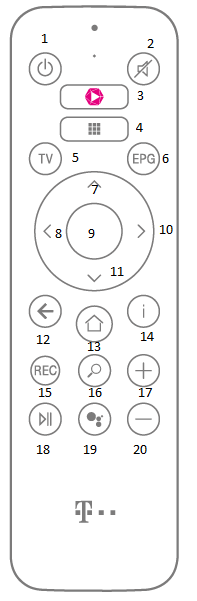

Hier die Codes der Tasten.
Zuordnung siehe Bild.
https://www.kodinerds.net/index.php/Atta…-MagentaTV-png/
Taste 1 Event: time 1609999699.995972, type 4 (EV_MSC), code 4 (MSC_SCAN), value c0030
Event: time 1609999699.995972, type 1 (EV_KEY), code 116 (KEY_POWER), value 1
Taste 2 Event: time 1609999279.950266, type 4 (EV_MSC), code 4 (MSC_SCAN), value c00e2
Event: time 1609999279.950266, type 1 (EV_KEY), code 113 (KEY_MUTE), value 1
Taste 3 Event: time 1609999329.313955, type 4 (EV_MSC), code 4 (MSC_SCAN), value 7006d
Event: time 1609999329.313955, type 1 (EV_KEY), code 188 (KEY_F18), value 1
Taste 4 Event: time 1609999357.689533, type 4 (EV_MSC), code 4 (MSC_SCAN), value c01a2
Event: time 1609999357.689533, type 1 (EV_KEY), code 580 (KEY_APPSELECT), value 1
Taste 5 Event: time 1609999393.702730, type 4 (EV_MSC), code 4 (MSC_SCAN), value c0089
Event: time 1609999393.702730, type 1 (EV_KEY), code 377 (KEY_TV), value 1
Taste 6 Event: time 1609999395.827695, type 4 (EV_MSC), code 4 (MSC_SCAN), value c008d
Event: time 1609999395.827695, type 1 (EV_KEY), code 362 (KEY_PROGRAM), value 1
Taste 7 Event: time 1609999460.341281, type 4 (EV_MSC), code 4 (MSC_SCAN), value c0042
Event: time 1609999460.341281, type 1 (EV_KEY), code 103 (KEY_UP), value 1
Taste 8 vent: time 1609999461.353824, type 4 (EV_MSC), code 4 (MSC_SCAN), value c0044
Event: time 1609999461.353824, type 1 (EV_KEY), code 105 (KEY_LEFT), value 1
Taste 9 Event: time 1609999462.803774, type 4 (EV_MSC), code 4 (MSC_SCAN), value c0041
Event: time 1609999462.803774, type 1 (EV_KEY), code 353 (KEY_SELECT), value 1
Taste 10 Event: time 1609999463.566327, type 4 (EV_MSC), code 4 (MSC_SCAN), value c0045
Event: time 1609999463.566327, type 1 (EV_KEY), code 106 (KEY_RIGHT), value 1
Taste 11 Event: time 1609999464.953822, type 4 (EV_MSC), code 4 (MSC_SCAN), value c0043
Event: time 1609999464.953822, type 1 (EV_KEY), code 108 (KEY_DOWN), value 1
Taste 12 Event: time 1609999553.718321, type 4 (EV_MSC), code 4 (MSC_SCAN), value c0224
Event: time 1609999553.718321, type 1 (EV_KEY), code 158 (KEY_BACK), value 1
Taste 13 Event: time 1609999554.355770, type 4 (EV_MSC), code 4 (MSC_SCAN), value c0223
Event: time 1609999554.355770, type 1 (EV_KEY), code 172 (KEY_HOMEPAGE), value 1
Taste 14 Event: time 1609999555.468273, type 4 (EV_MSC), code 4 (MSC_SCAN), value c01bd
Event: time 1609999555.468273, type 1 (EV_KEY), code 358 (KEY_INFO), value 1
Taste 15 Event: time 1609999596.956882, type 4 (EV_MSC), code 4 (MSC_SCAN), value c00b2
Event: time 1609999596.956882, type 1 (EV_KEY), code 167 (KEY_RECORD), value 1
Taste 16 Event: time 1609999597.406870, type 4 (EV_MSC), code 4 (MSC_SCAN), value 7006b
Event: time 1609999597.406870, type 1 (EV_KEY), code 186 (KEY_F16), value 1
Taste 17 Event: time 1609999598.106886, type 4 (EV_MSC), code 4 (MSC_SCAN), value c00e9
Event: time 1609999598.106886, type 1 (EV_KEY), code 115 (KEY_VOLUMEUP), value 1
Taste 18 Event: time 1609999633.694928, type 4 (EV_MSC), code 4 (MSC_SCAN), value c00cd
Event: time 1609999633.694928, type 1 (EV_KEY), code 164 (KEY_PLAYPAUSE), value 1
Taste 19 Event: time 1609999634.244905, type 4 (EV_MSC), code 4 (MSC_SCAN), value c0221
Event: time 1609999634.244905, type 1 (EV_KEY), code 217 (KEY_SEARCH), value 1
Taste 20 Event: time 1609999634.844682, type 4 (EV_MSC), code 4 (MSC_SCAN), value c00ea
Event: time 1609999634.844682, type 1 (EV_KEY), code 114 (KEY_VOLUMEDOWN), value 1
