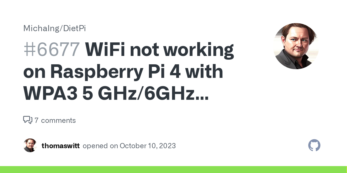

    Hier:
    WiFi not working on Raspberry Pi 4 with WPA3 5 GHz/6GHz only-Network · Issue #6677 · MichaIng/DietPi
    Required Information DietPi version | 8.22.3 Distro version | bookworm 0 Kernel version | Linux MyPi 6.1.21-v8+ # 1642 SMP PREEMPT Mon Apr 3 17:24:16 BST 2023…
    github.com
    reden die davon, dass das WPA3 Problem via Firmware behoben sein würde ..., vlt. auch in LE nightly ?

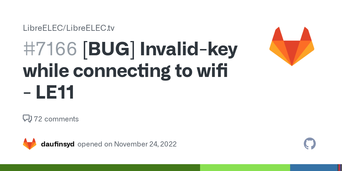

    [BUG] Invalid-key while connecting to wifi - LE11 · Issue #7166 · LibreELEC/LibreELEC.tv
    Describe the bug Hello :) Since upgrading to LireElec 10 (10.0.3) the wifi is really unstable. Every now and then, LibreElec will forget the wifi password and…
    github.com
