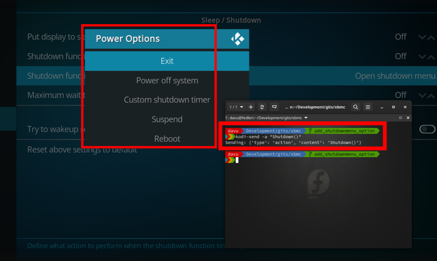

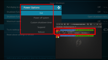

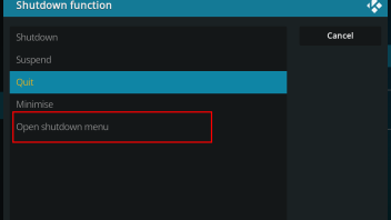

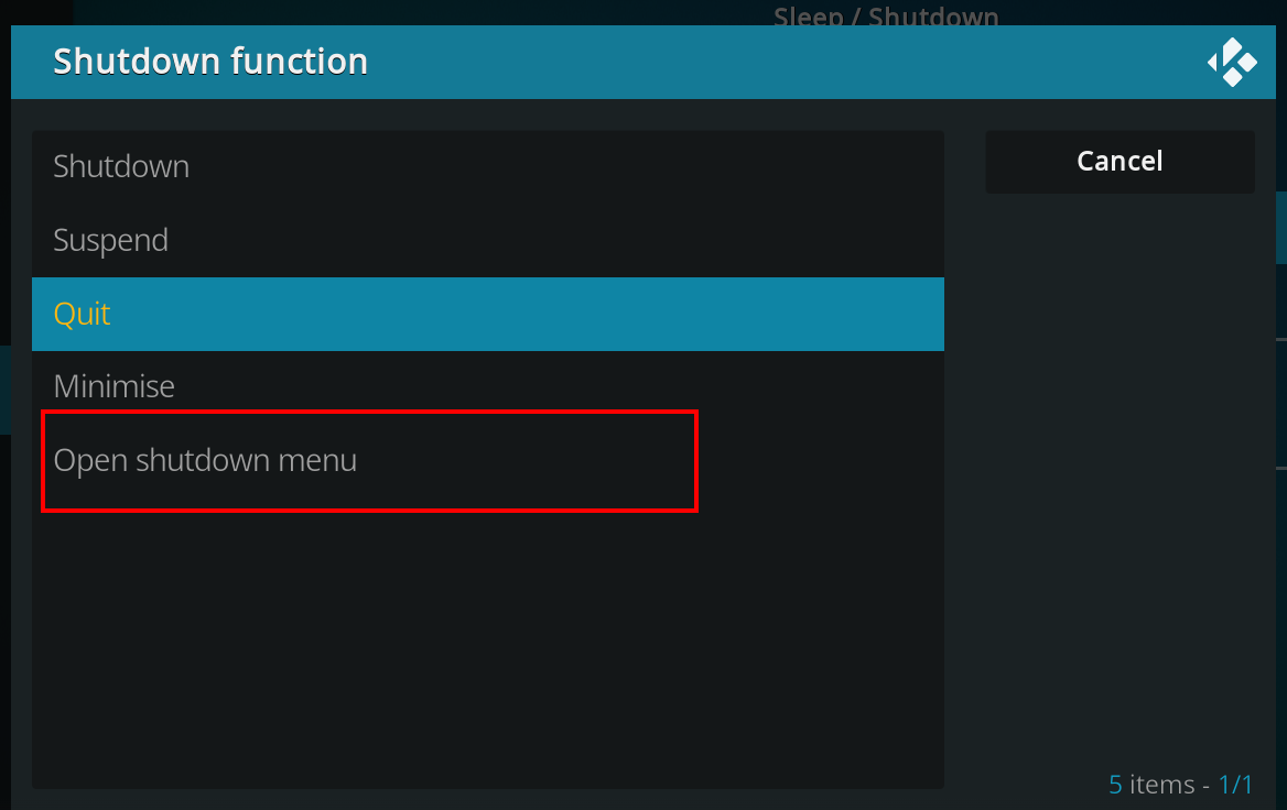

  • Ich habe hier mal einen Vorschlag gemacht:
    Switch remote poweroff button behaviour to show shutdown menu, like on keyboards by HiassofT · Pull Request #23806 · xbmc/xbmc
    Description When pressing poweroff on a keyboard, (PC) case power button or keyboard-like remote Kodi shows the shutdown menu. However, when pressing the…
    github.com
    Mal hören, was so gesagt wird? ;)
