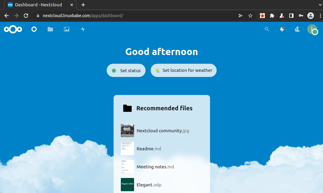

    Hast du alle nötigen PHP Pakete installiert? Quelle:
    Install NextCloud on Ubuntu 22.04 (Nginx + PostgreSQL + PHP8)
    Nextcloud is much faster with PostgreSQL. This tutorial will be showing you how to install NextCloud on Ubuntu 22.04 with Nginx/PostgreSQL.
    www.linuxbabe.com
    Siehe "Step 4":
    sudo apt install imagemagick php-imagick php8.1-common php8.1-pgsql php8.1-fpm php8.1-gd php8.1-curl php8.1-imagick php8.1-zip php8.1-xml php8.1-mbstring php8.1-bz2 php8.1-intl php8.1-bcmath php8.1-gmp
