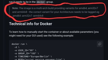

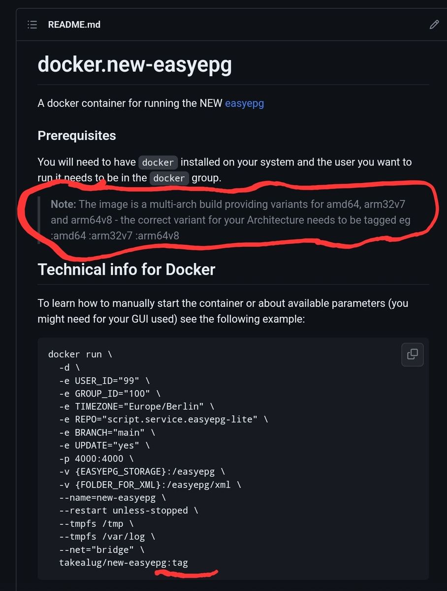

Unable to find image 'takealug/new-easyepg:tag' locally
docker: Error response from daemon: manifest for takealug/new-easyepg:tag not found: manifest unknown: manifest unknown.

Dann müsste es :amd64 sein.
Aber wo und wie muß ich :amd64 einfügen ?
Ist es so alles in Ordnung ?
Der Odner xml ist leider noch leer ??
-v /volume1/docker/easyepg/xml:/xml \
Alles anzeigenUnable to find image 'takealug/new-easyepg:amd64' locally amd64: Pulling from takealug/new-easyepg a603fa5e3b41: Pulling fs layer f8742d00764a: Pulling fs layer 1b6dbbc62ed4: Pulling fs layer e005d836addb: Pulling fs layer 3841f58da6a2: Pulling fs layer 5af325a90031: Pulling fs layer e005d836addb: Waiting 3841f58da6a2: Waiting 5af325a90031: Waiting 1b6dbbc62ed4: Verifying Checksum 1b6dbbc62ed4: Download complete f8742d00764a: Verifying Checksum f8742d00764a: Download complete a603fa5e3b41: Verifying Checksum a603fa5e3b41: Download complete a603fa5e3b41: Pull complete e005d836addb: Verifying Checksum e005d836addb: Download complete 3841f58da6a2: Verifying Checksum 3841f58da6a2: Download complete f8742d00764a: Pull complete 5af325a90031: Verifying Checksum 5af325a90031: Download complete 1b6dbbc62ed4: Pull complete e005d836addb: Pull complete 3841f58da6a2: Pull complete 5af325a90031: Pull complete Digest: sha256:f1cbae25f62c55d50fd3cad5c69eec9468785dae4599001b7e39f49d93d8df9f Status: Downloaded newer image for takealug/new-easyepg:amd64 6f8074b697f99b1c3f94cc0287c3964b62e649d9260026cc3ec1641cac001eeb

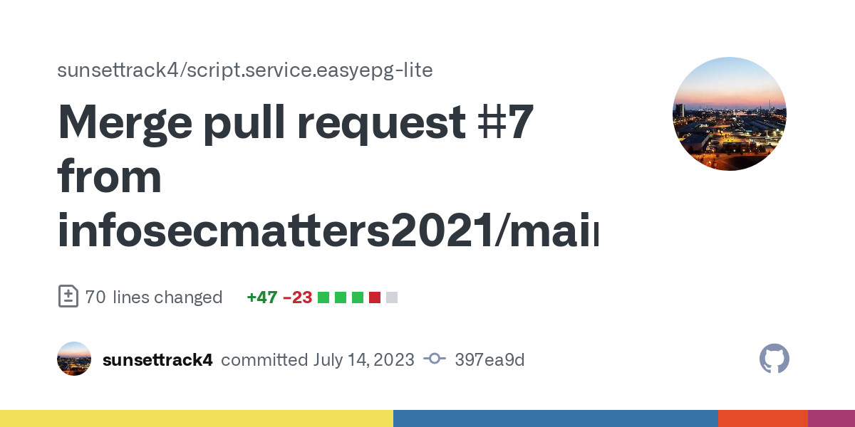

Merge pull request #7 from infosecmatters2021/main · sunsettrack4/script.service.easyepg-lite@397ea9d#6 - Request: please include qualifiers - new, live and premieregithub.com -
