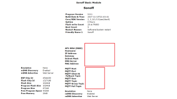

  • Sonoff Basics works fine here. Is your sonoff flashed with Tasmota firmware? With original firmware (ewelink) the addon will not work.
  • So if your sonoff is not flashed with Tasmota firmware (this is a replacement for ewelink), the addon will not work.
  • I changed the FW to be Tasmota Succesfully
    and it gives me Undefined!
    with this [definition='1','0']log[/definition]:

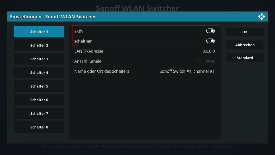

    2019-03-07 10:37:06.904 T:7324 DEBUG: [script.homematic.sonoff 0.0.7] Sonoff1, channel #1 (192.168.1.11) is not switchable
    what is the issue here :whistling:
  • Go to addon -> settings and enable for switch #1
    • active
    • switchable
