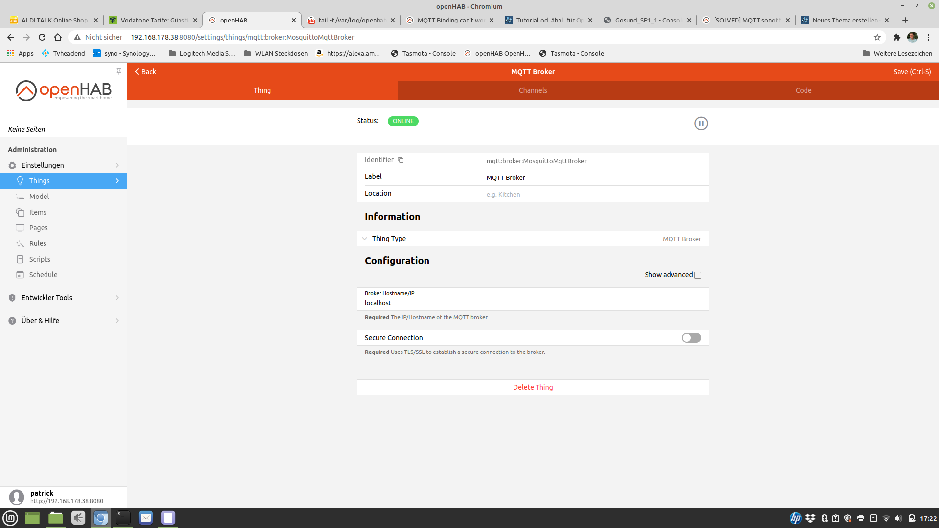

  • Im OH Webinterface steht noch was von :
    If this and SSL is set: After the next connection has been successfully established, the certificate is pinned. The connection will be refused if another certificate is used. Clear **certificate** to allow a new certificate for the next connection attempt. This option can increase security.
    Ist da irgendwo ein Ansatzpunkt?
