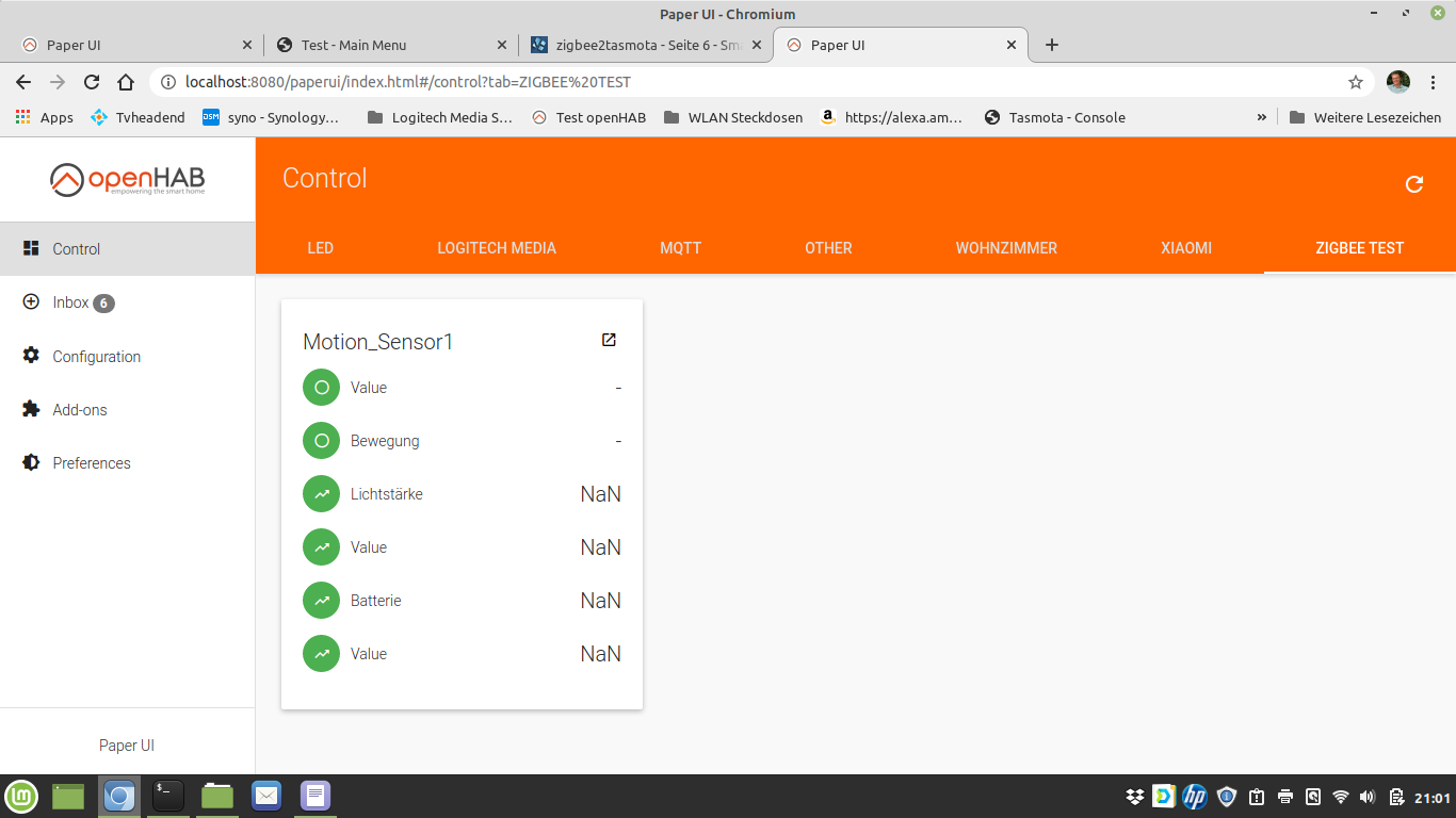

  • Oder habe ich die items falsch angelegt??
    String    Motion_Sensor1_Occupancy "Bewegung"   {channel="mqtt:topic:embedded-mqtt-broker:Motion_Sensor1:Motion_Sensor1_Occupancy"}
    Number    Motion_Sensor1_Illuminance "Lichtstärke"   {channel="mqtt:topic:embedded-mqtt-broker:Motion_Sensor1:Motion_Sensor1_Illuminance"}
    Number    Motion_Sensor1_Battery    "Batterie"  {channel="mqtt:topic:embedded-mqtt-broker:Motion_Sensor1:Motion_Sensor1_Battery"}
  • Der Sensor läuft anscheinend
  • Code
    2021-01-19 17:40:07.317 [hingStatusInfoChangedEvent] - 'mqtt:topic:embedded-mqtt-broker:Motion_Sensor1' changed from UNINITIALIZED to INITIALIZING
    2021-01-19 17:40:07.371 [hingStatusInfoChangedEvent] - 'mqtt:topic:embedded-mqtt-broker:Motion_Sensor1' changed from INITIALIZING to ONLINE
    um 17:45 triggert der Sensor laut Tasmot Console
    17:45:02.978 MQT: tele/bridge/SENSOR = {"ZbReceived":{"Motion_Sensor1":{"Device":"0x4709","Name":"Motion_Sensor1","Illuminance":4,"Occupancy":1,"Endpoint":1,"LinkQuality":107}}}
    17:46:11.443 MQT: tele/bridge/STATE = {"Time":"2021-01-19T17:46:11","Uptime":"0T00:10:09","UptimeSec":609,"Vcc":3.530,"Heap":27,"SleepMode":"Dynamic","Sleep":50,"LoadAvg":19,"MqttCount":1,"Wifi":{"AP":1,"SSId":"FRITZ!Box 7490","BSSId":"5C:49:79:38:9F:44","Channel":6,"RSSI":64,"Signal":-68,"LinkCount":1,"Downtime":"0T00:00:03"}}
    17:46:32.655 MQT: tele/bridge/SENSOR = {"ZbReceived":{"Motion_Sensor1":{"Device":"0x4709","Name":"Motion_Sensor1","Occupancy":0}}}
    aber im OpenHAB [definition='1','0']log[/definition] tut sich nichts. Das sich ein item verändert hat.....
    Müsste aber doch - oder?
