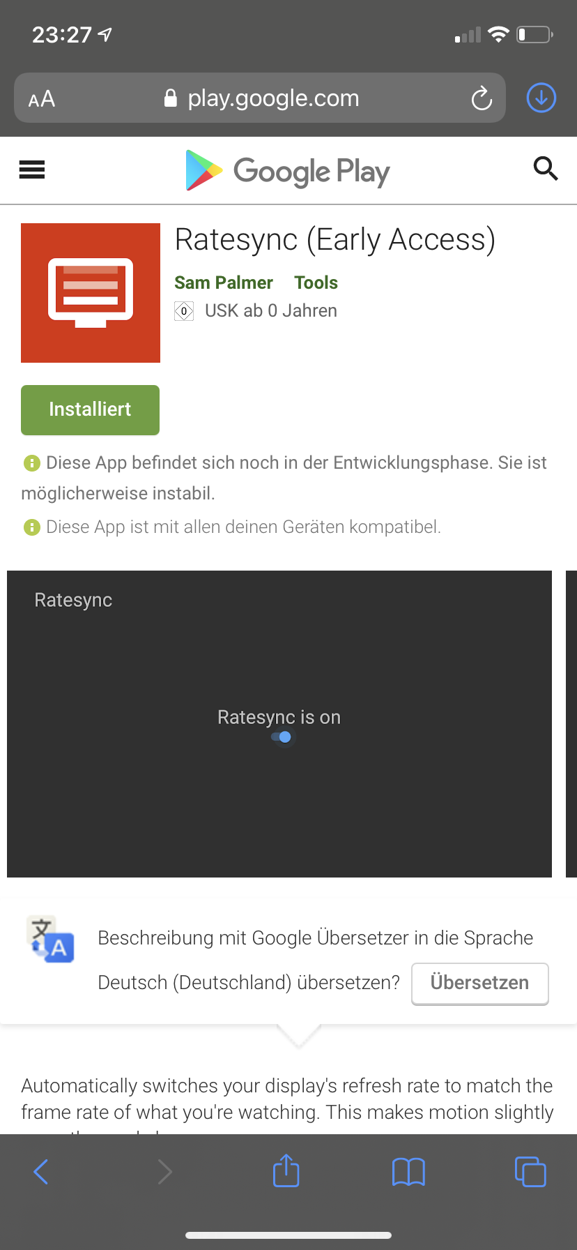

    Neues Projekt: Ratesync
    Aktuell:
    * Only works with Netflix
    * Only runs on NVIDIA Shield TV
    * If you have the Refresh Rate app installed, then leave Netflix set to "system default" so the apps don't clash
    * Focus on bugs and stability
    * Consider switching on previews in your Netflix account profile to test that they don't cause issues
