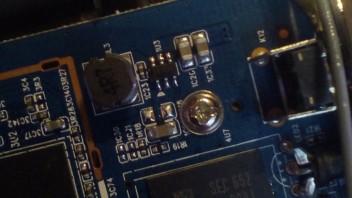

  • WARNING: There's a bad batch of M8S Pro+ boxes which are experiencing regular freezing and crashes. We've narrowed the source of the problem down to a Samsung eMMC 5.1 chipset (KLMAG1JENB - B041), batches SEC 652 to 713, and these usually shipped from the factory with version 20170829.121614.V0321 of the OEM firmware. If you have one of these, it's highly recommended that you not flash any ROM (custom or OEM), as the prolonged block writes seem to result in serious data corruption.
    Das ist auf freaktab darüber zu lesen in Bezug auf den Chip.
    Die genaue Info mit Bildern war dort irgendwo in einem extra Thema vergraben.
    Da muß ich nochmals suchen, es war so spät.
