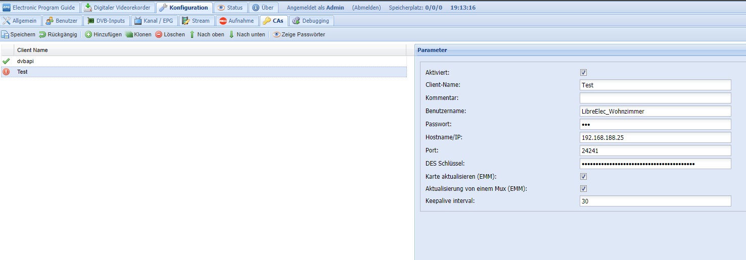

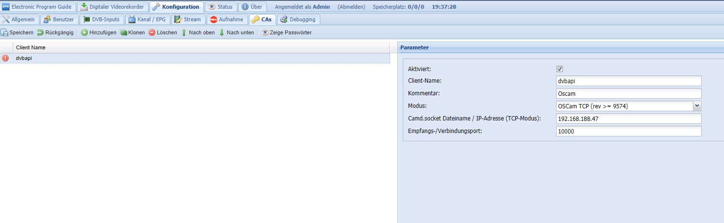

    Jetzt hab ich gesehen das ich wohl in TVHeadend auch noch etwas konfigurieren muss, das hab ich dann mal nach bestem wissen so gemacht wie im Anhang zu sehen, allerdings bekomme ich dann immer die Meldung in TVHeadend
    2017-11-09 05:31:12.712 capmt: DVBApi: Cannot connect to 192.168.188.47 (No such file or directory); Do you have OSCam running?
    2017-11-09 05:31:12.712 capmt: DVBApi: Automatic reconnection attempt in in 3 seconds
    2017-11-09 05:31:15.708 capmt: DVBApi: Cannot connect to 192.168.188.47 (No such file or directory); Do you have OSCam running?
    2017-11-09 05:31:15.708 capmt: DVBApi: Automatic reconnection attempt in in 3 seconds
    2017-11-09 05:31:18.482 subscription: 003D: "epggrab" unsubscribing
    2017-11-09 05:31:18.663 capmt: DVBApi: Cannot connect to 192.168.188.47 (No such file or directory); Do you have OSCam running?
    2017-11-09 05:31:18.663 capmt: DVBApi: Automatic reconnection attempt in in 60 seconds
    Wieso auch immer kommt die Verbindung nicht zustande.
    Anbei mal die Konfig Datein, hoffe hier hat einer eine idee.

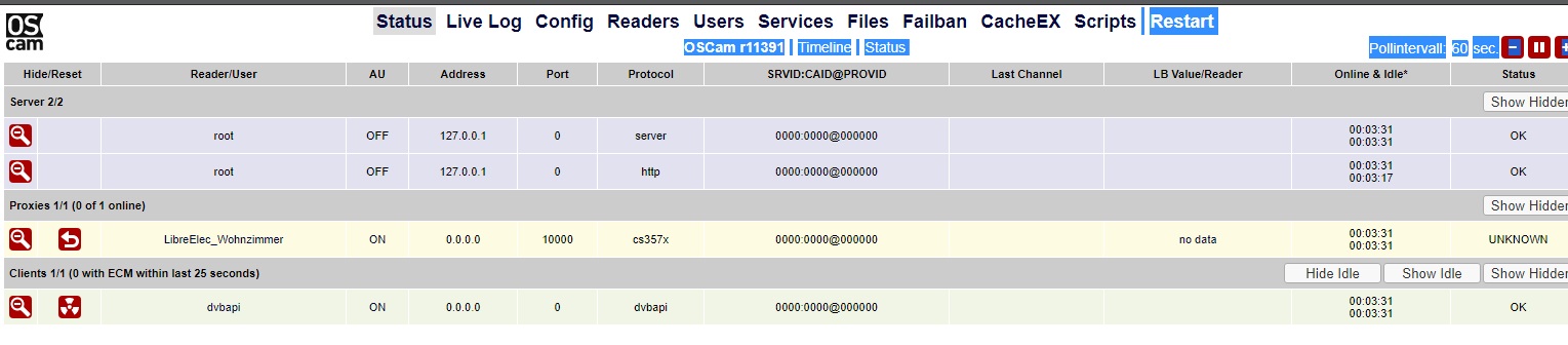

    [global]logfile = /var/tbmodlog/ipc/OScam.logcachedelay                    = 120maxlogsize                    = 50disablelog                    = 0clienttimeout                 = 10000fallbacktimeout               = 2500clientmaxidle                 = 120bindwait                      = 120netprio                       = 1resolvegethostbyname          = 0nice                          = -1waitforcards                  = 1preferlocalcards              = 1readerrestartseconds          = 5saveinithistory               = 1lb_mode = 1lb_save = 100lb_savepath = /tmp/.oscam/statlb_auto_betatunnel =  1[cs357x]port = 10000[webif]httpport                      = +2000httpuser                      = Adminhttppwd                       = xxxhttpcss = /var/InternerSpeicher/service/oscam/style.csshttprefresh                   = 10httphideidleclients           = 25httpallowed                   = 192.168.188.0-192.168.188.254httpreadonly                  = 0httphelplang                  = de[monitor]port                          = 0nocrypt                       = 192.168.188.0-192.168.188.50aulow                         = 30hideclient_to                 = 0monlevel                      = 2appendchaninfo                = 1
    oscam.server

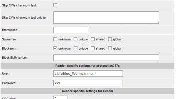

    [reader]label                         = KD_HD_D02_Skyprotocol                      = mousedevice                        = /dev/ttyUSB0caid                          = 1722,1834boxkey                        = 1122334455667788detect                        = cdmhz                           = 600cardmhz                       = 600group                         = 1emmcache                      = 1,3,2
    oscam.user
    [account]user           = Ultimopwd            = xxxgroup          = 1au             = 1[account]user           = UnoSchlafzimmerpwd            = xxxgroup          = 1au             = 1[account]user           = UnoKellerbarpwd            = xxxgroup          = 1[account]user           = LibreElec_Wohnzimmerpwd            = xxxgroup          = 1au             = 1
    LibreElec Client
    "Client"
    oscam.conf
    [global]logfile                       = /var/tmp/oscam.logclienttimeout                 = 70000fallbacktimeout               = 600cachedelay                    = 120nice                          = -10maxlogsize                    = 300saveinithistory               = 1lb_nbest_readers              = 3[dvbapi]enabled                       = 1au                               = 1boxtype                       = pc-nodmxuser                           = dvbapi[webif]httpport                      = 83httprefresh                   = 10httpallowed                   = 192.168.188.0-255.255.255.0httphideidleclients           = 1
    oscam.user
    oscam.server

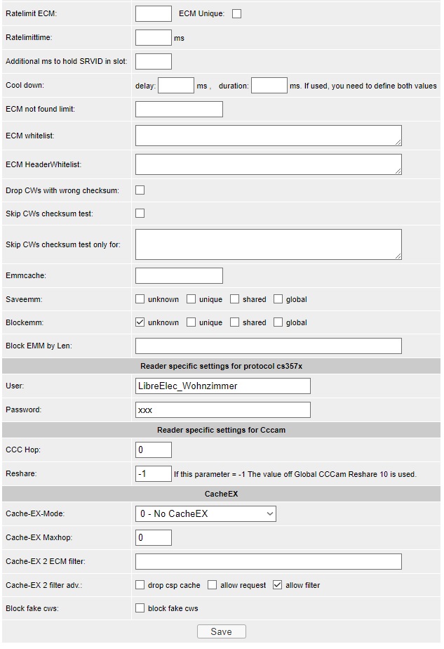

    [reader]label = LibreElec_Wohnzimmerprotocol = cs357xdevice = 192.168.188.47,10000user = LibreElec_Wohnzimmerpassword = xxxcaid = 1722,1834group = 1inactivitytimeout = 240blockemm-unknown = 1

  • Du musst DVBApi schon auch noch aktivieren.
    Oscam.conf (Beispiel)
    [dvbapi]
    enabled                       = 1
    au                            = 1
    pmt_mode                      = 4
    listen_port                   = 1234
    user                          = xxxxx
    boxtype                       = pc
    Dann bei TVH auf "OSCam TCP (rev >= 9574)" und IP + Port rein.
    "I don't caretaker"
  • Hi,
    also die oscam.conf auf dem Client sieht jetzt so aus:
    TVHeadend sieht so aus wie im Anhang, nur leider funktionieren tut es nicht.

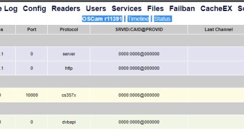

    Im Oscam WebIF des Clienten kommt mir aber auch noch seltsam vor das bei "Adresse" 0.0.0.0 steht, da müsste doch die IP des Servers stehen,also 192.168.188.47 oder nicht? Zumindest ist dies bei meinen VU+ Boxen so.
  • Versteh ich das richtig, unter TVHeadend muss die IPdes Oscam Clients (ist ja in beiden fällen die Wetek Box) rein? Nicht wie ich es gemacht hab die IP des Oscam Servers?
    EDIT, hab jetzt mal die IP des OScam Clienten eingetragen und schon sieht es etwas anders aus
    2017-11-09 20:30:28.528 capmt: dvbapi: mode 3 connected to 192.168.188.25:10000 (single)
    2017-11-09 20:30:28.529 capmt: dvbapi inactive
    Aber mit dvbapi stimmt wohl immer noch was nicht
  • Auf welchen Gerät ist TVH und wo Oscam? DVBapi gibts doch nur local auf dem Gerät, wo auch der Tuner ist, so war es zumindest bei den Receivern immer.

  • Die IP steht aber bei TVH drin, weil tvh auf dvbapi zugreift und nicht umgekehrt. In der oscam.conf steht nur der Port, wo dvbapi erreichbar ist. Auf Geräten ohne eigenen Tuner ist dvbapi nutzlos und wird gar nicht verwendet.
