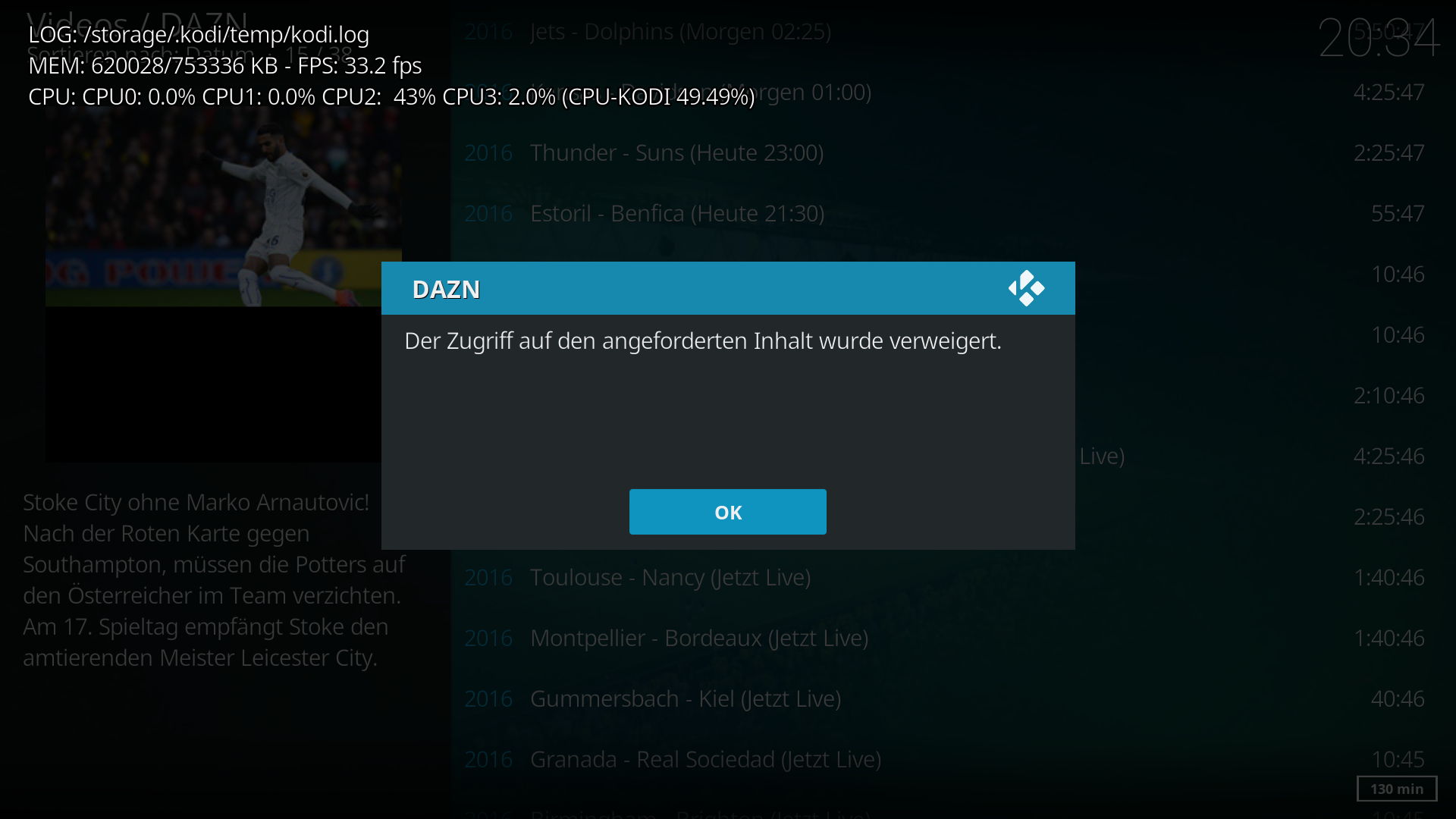

Ich habe auch versucht DAZN auf meinem neuen RPi3 mit Kodi 17 zum Laufen zu bringen, aber es funktioniert leider nicht.
Hier einmal ein Auszug aus dem [definition='1','3']Debug[/definition] Logfile, vielleicht wird ja jemand daraus schlau:Spoiler anzeigen
Alles anzeigen19:15:46.100 T:1571812256 NOTICE: [plugin.video.dazn] arguments: 0.6.3 19:15:49.476 T:1571812256 NOTICE: [plugin.video.dazn] arguments: {'title': ['Was l\xc3\xa4uft'], 'id': ['Scheduled'], 'mode': ['rail']} 19:15:54.199 T:1571812256 NOTICE: [plugin.video.dazn] arguments: {'title': ['West Brom - Manchester United (Jetzt Live)'], 'params': ['Scheduled'], 'id': ['14imvzezqegt51bek2l17o97la'], 'mode': ['play']} 19:15:54.383 T:1571812256 NOTICE: [plugin.video.dazn] error: Access to the requested content has been denied. (7) 19:15:56.895 T:1961689088 NOTICE: VideoPlayer: Opening: 19:15:56.895 T:1961689088 WARNING: CDVDMessageQueue(player)::Put MSGQ_NOT_INITIALIZED 19:15:56.896 T:1634726816 NOTICE: Creating InputStream 19:15:56.991 T:1634726816 ERROR: AddOnLog: InputStream Adaptive: Invalid mpdURL: / expected () 19:15:56.992 T:1634726816 ERROR: CVideoPlayer::OpenInputStream - error opening [] 19:15:56.992 T:1634726816 NOTICE: CVideoPlayer::OnExit() 19:15:56.993 T:1961689088 ERROR: Playlist Player: skipping unplayable item: 0, path [plugin://plugin.video.dazn/?id=14imvzezqegt51bek2l17o97la¶ms=Scheduled&mode=play&title=West+Brom+-+Manchester+United+(Jetzt+Live)] 19:15:56.993 T:1961689088 NOTICE: CVideoPlayer::CloseFile() 19:15:56.993 T:1961689088 NOTICE: VideoPlayer: waiting for threads to exit 19:15:56.993 T:1961689088 NOTICE: VideoPlayer: finished waiting 19:15:56.993 T:1961689088 NOTICE: CVideoPlayer::CloseFile() 19:15:56.993 T:1961689088 NOTICE: VideoPlayer: waiting for threads to exit 19:15:56.993 T:1961689088 NOTICE: VideoPlayer: finished waiting 19:15:59.859 T:1563423648 NOTICE: [plugin.video.dazn] arguments: 0.6.3 19:16:01.157 T:1601172384 ERROR: Unable to find plugin 19:16:01.157 T:1961689088 ERROR: GetDirectory - Error getting plugin:// 19:16:01.158 T:1961689088 ERROR: CGUIMediaWindow::GetDirectory(plugin://) failed 19:15:46.100 T:1571812256 NOTICE: [plugin.video.dazn] arguments: 0.6.3 19:15:49.476 T:1571812256 NOTICE: [plugin.video.dazn] arguments: {'title': ['Was l\xc3\xa4uft'], 'id': ['Scheduled'], 'mode': ['rail']} 19:15:54.199 T:1571812256 NOTICE: [plugin.video.dazn] arguments: {'title': ['West Brom - Manchester United (Jetzt Live)'], 'params': ['Scheduled'], 'id': ['14imvzezqegt51bek2l17o97la'], 'mode': ['play']} 19:15:54.383 T:1571812256 NOTICE: [plugin.video.dazn] error: Access to the requested content has been denied. (7) 19:15:56.895 T:1961689088 NOTICE: VideoPlayer: Opening: 19:15:56.895 T:1961689088 WARNING: CDVDMessageQueue(player)::Put MSGQ_NOT_INITIALIZED 19:15:56.896 T:1634726816 NOTICE: Creating InputStream 19:15:56.991 T:1634726816 ERROR: AddOnLog: InputStream Adaptive: Invalid mpdURL: / expected () 19:15:56.992 T:1634726816 ERROR: CVideoPlayer::OpenInputStream - error opening [] 19:15:56.992 T:1634726816 NOTICE: CVideoPlayer::OnExit() 19:15:56.993 T:1961689088 ERROR: Playlist Player: skipping unplayable item: 0, path [plugin://plugin.video.dazn/?id=14imvzezqegt51bek2l17o97la¶ms=Scheduled&mode=play&title=West+Brom+-+Manchester+United+(Jetzt+Live)] 19:15:56.993 T:1961689088 NOTICE: CVideoPlayer::CloseFile() 19:15:56.993 T:1961689088 NOTICE: VideoPlayer: waiting for threads to exit 19:15:56.993 T:1961689088 NOTICE: VideoPlayer: finished waiting 19:15:56.993 T:1961689088 NOTICE: CVideoPlayer::CloseFile() 19:15:56.993 T:1961689088 NOTICE: VideoPlayer: waiting for threads to exit 19:15:56.993 T:1961689088 NOTICE: VideoPlayer: finished waiting 19:15:59.859 T:1563423648 NOTICE: [plugin.video.dazn] arguments: 0.6.3 19:16:01.157 T:1601172384 ERROR: Unable to find plugin 19:16:01.157 T:1961689088 ERROR: GetDirectory - Error getting plugin:// 19:16:01.158 T:1961689088 ERROR: CGUIMediaWindow::GetDirectory(plugin://) failed 19:15:46.100 T:1571812256 NOTICE: [plugin.video.dazn] arguments: 0.6.3 19:15:49.476 T:1571812256 NOTICE: [plugin.video.dazn] arguments: {'title': ['Was l\xc3\xa4uft'], 'id': ['Scheduled'], 'mode': ['rail']} 19:15:54.199 T:1571812256 NOTICE: [plugin.video.dazn] arguments: {'title': ['West Brom - Manchester United (Jetzt Live)'], 'params': ['Scheduled'], 'id': ['14imvzezqegt51bek2l17o97la'], 'mode': ['play']} 19:15:54.383 T:1571812256 NOTICE: [plugin.video.dazn] error: Access to the requested content has been denied. (7) 19:15:56.895 T:1961689088 NOTICE: VideoPlayer: Opening: 19:15:56.895 T:1961689088 WARNING: CDVDMessageQueue(player)::Put MSGQ_NOT_INITIALIZED 19:15:56.896 T:1634726816 NOTICE: Creating InputStream 19:15:56.991 T:1634726816 ERROR: AddOnLog: InputStream Adaptive: Invalid mpdURL: / expected () 19:15:56.992 T:1634726816 ERROR: CVideoPlayer::OpenInputStream - error opening [] 19:15:56.992 T:1634726816 NOTICE: CVideoPlayer::OnExit() 19:15:56.993 T:1961689088 ERROR: Playlist Player: skipping unplayable item: 0, path [plugin://plugin.video.dazn/?id=14imvzezqegt51bek2l17o97la¶ms=Scheduled&mode=play&title=West+Brom+-+Manchester+United+(Jetzt+Live)] 19:15:56.993 T:1961689088 NOTICE: CVideoPlayer::CloseFile() 19:15:56.993 T:1961689088 NOTICE: VideoPlayer: waiting for threads to exit 19:15:56.993 T:1961689088 NOTICE: VideoPlayer: finished waiting 19:15:56.993 T:1961689088 NOTICE: CVideoPlayer::CloseFile() 19:15:56.993 T:1961689088 NOTICE: VideoPlayer: waiting for threads to exit 19:15:56.993 T:1961689088 NOTICE: VideoPlayer: finished waiting 19:15:59.859 T:1563423648 NOTICE: [plugin.video.dazn] arguments: 0.6.3 19:16:01.157 T:1601172384 ERROR: Unable to find plugin 19:16:01.157 T:1961689088 ERROR: GetDirectory - Error getting plugin:// 19:16:01.158 T:1961689088 ERROR: CGUIMediaWindow::GetDirectory(plugin://) failed

Hier einmal ein Auszug aus dem [definition='1','3']Debug[/definition] Logfile, vielleicht wird ja jemand daraus schlau:Der nötige Decrypter wird nicht gefunden.
Die Lösung findest du hier, dabei solltest du die Postings 1,2 und 4 abarbeiten, dann läuft DAZN bei dir.

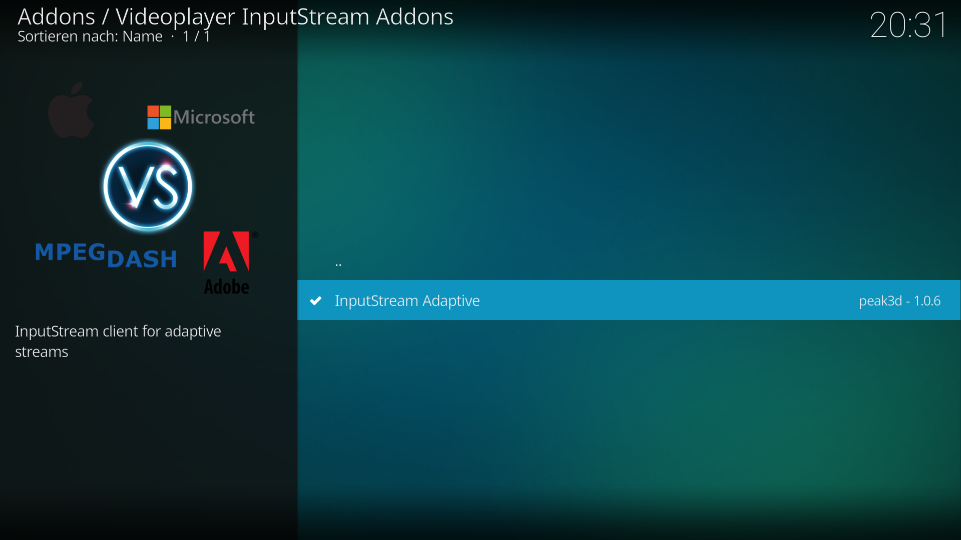

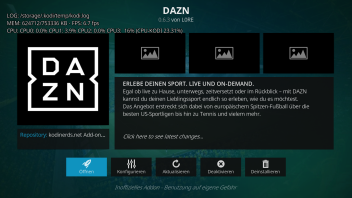

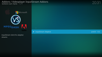

1. hab ich DAZN 0.63 installiert (was ja im Wohnzimmer einwandfrei geht)
2. ist das inputstream.adaptive aktuell (1.0.6)
3. geht ja z.B. Skygo einwandfrei !Ich habe schon alles versucht, aber DAZN geht einfach nicht.
