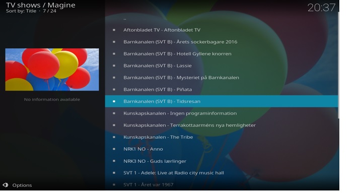

    I was wrong about the fact that you can not play Swedish Channels live. :(
    In my defense there are two things that confuse me. ?(
    The first one is the fact that there are lots of SVT1 channel icons on the TV Stations Screen.
    (Look at the attached file.)
    One of them is actually the right live one, and it works! :thumbup:
    But, when I go to Mediathek to check which one who should be running now, I see that that the "current" program is not there. :(
    But it is not true. :thumbup:
    In the Mediathek the Swedish channels have the wrong start time :!:
    They are one hour backdated. This confused me for quite a while.
    The program that REALLY started at 19:00 and ended at 20:00 looks like
    it started at 18:00 and ended at 19:00 in the Mediathek.
    Why that is I do not know. ?(
    so,
    It would be good to get rid of the extra icons in TV Channels and
    have the right Start times in the Mediathek.
    /PAD ¤
  • @'LORE'
    I think I have misunderstood part of your programming.
    Sorry about that.
    The TV Stations menu is actually the "ON TV" thing at Magine.
    I thought it was Channels.
    I think that "ON TV" it is a good thing to have but I miss the Channels menu point.
    A single point where all MY channels are gathered and where I can start
    live tv and see what is on right now.
    I do not know if its possible to create one but that would make the addon a lot
    better when it comes to live-tv.
    The reason for that is that there are channels missing from the ON TV menu.
    My Norwegian channels are not there.
    So I can not reach them at all.
    What is your opinion on this ?
    btw the Norwegian Channels are also missing from the Mediathek.
    /PAD ¤
  • @'LORE'
    Strange my last comment disppeared.
    ok, here we go again.
    For some reason the urls on the TV Stations menu
    sometimes takes me to another program that is not live.
    All the channels have the right name and programs but the url for
    that entry does not always work.
    I can find the current live program in the mediathek and start it from there
    but it does not always work from the tv stations menu.
    I can add that it seems as if channels work the first time.
    When I return to them they show the program from the last visit....
